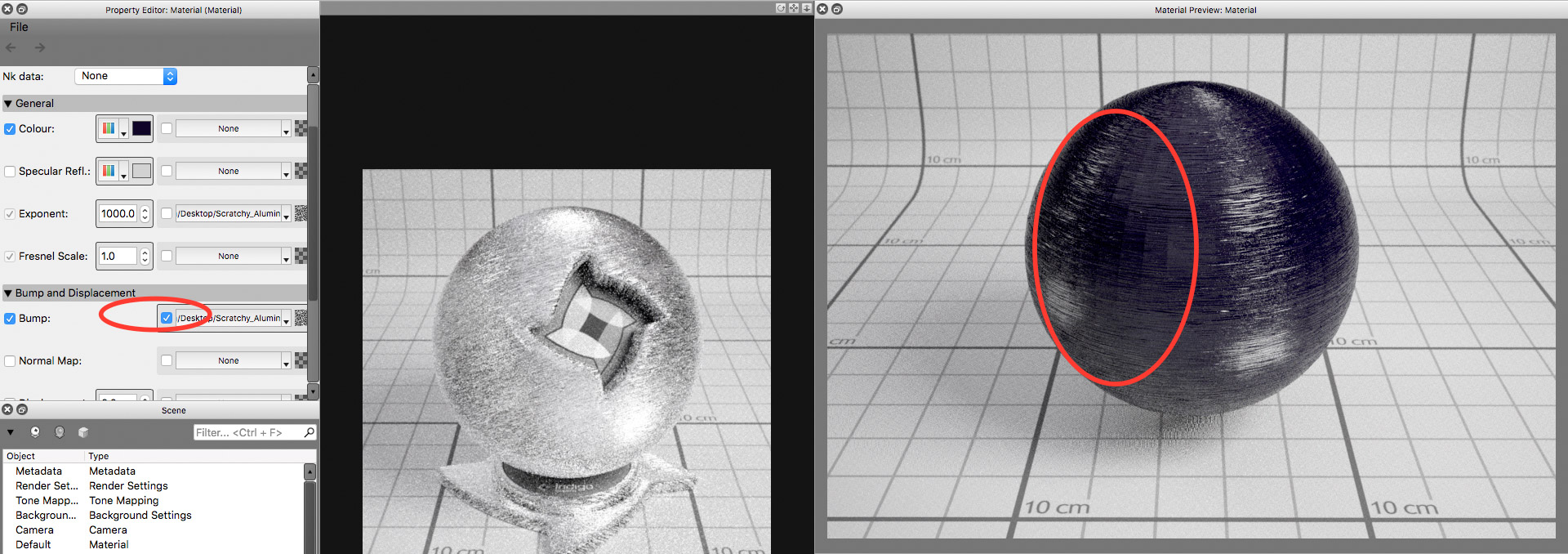

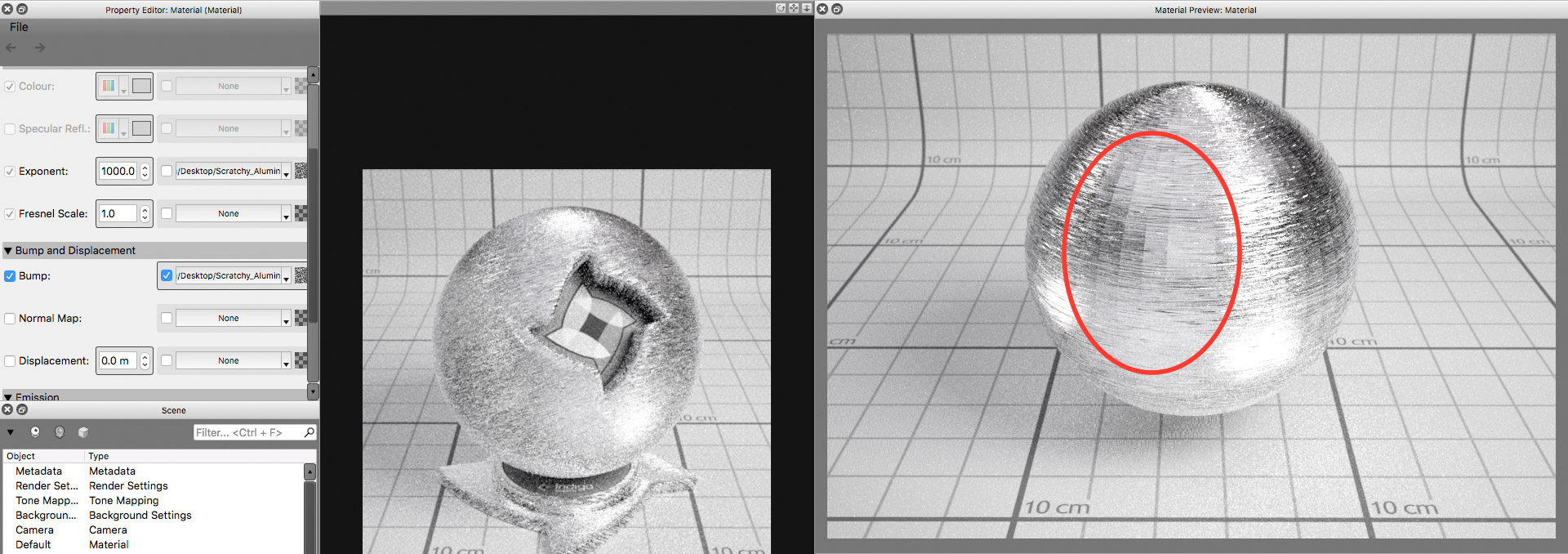

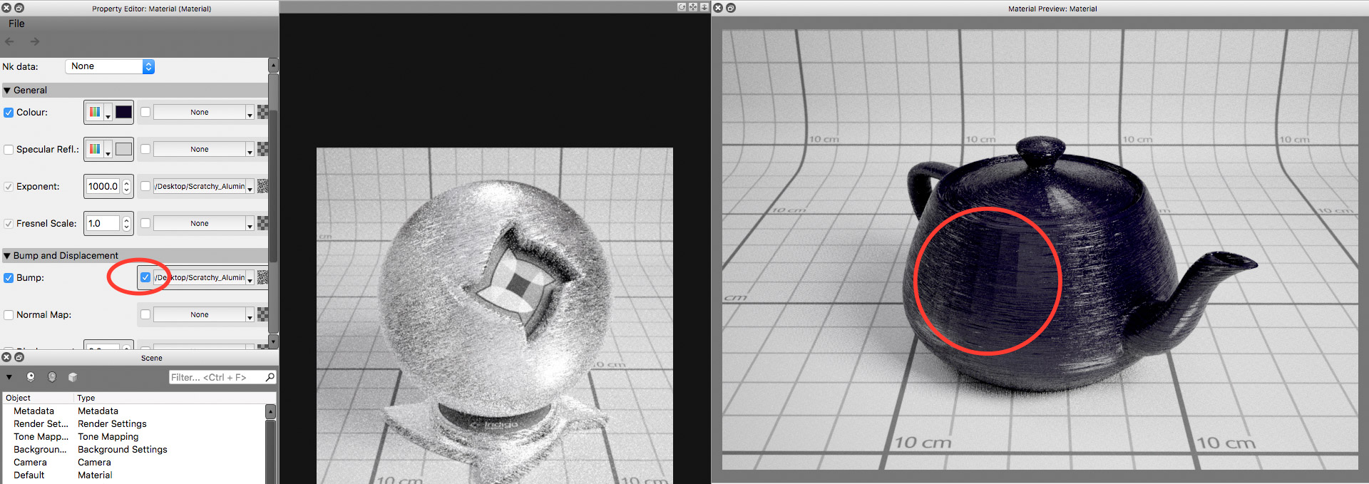

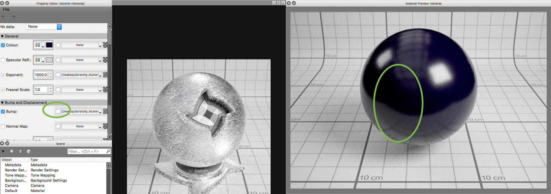

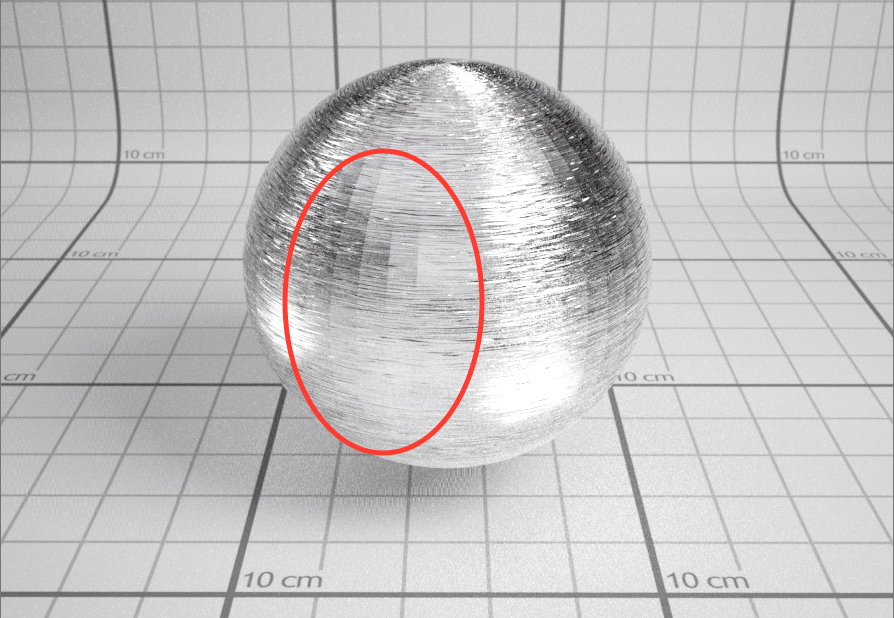

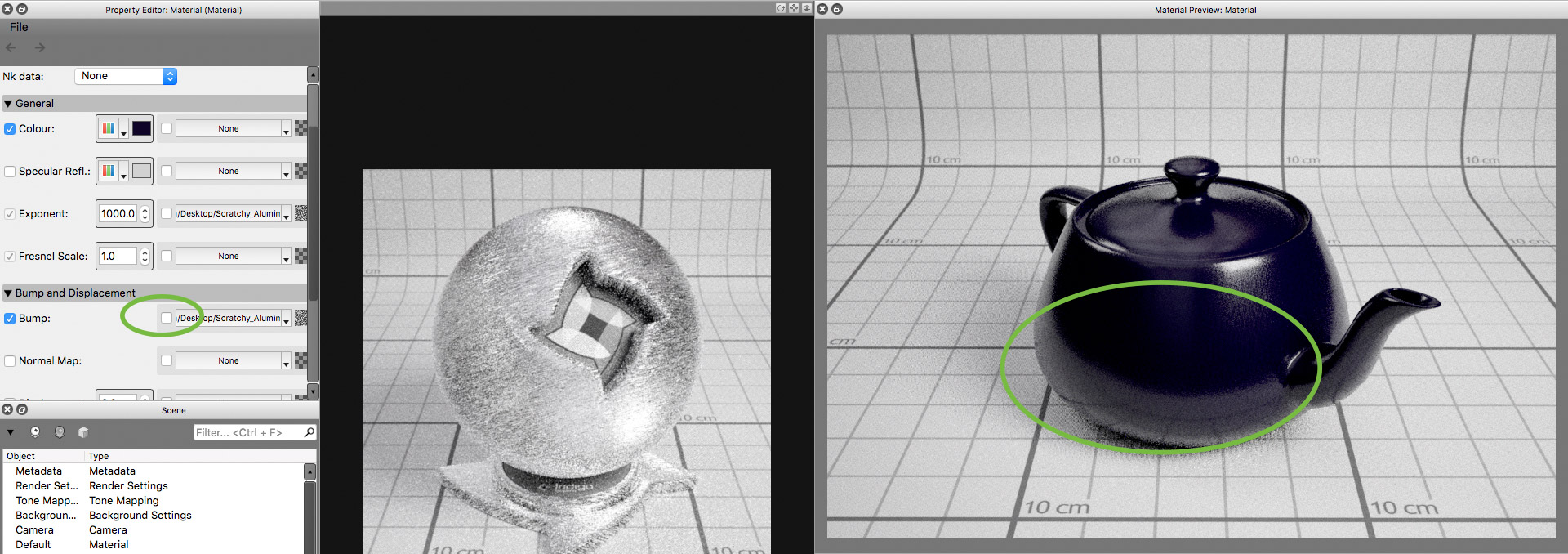

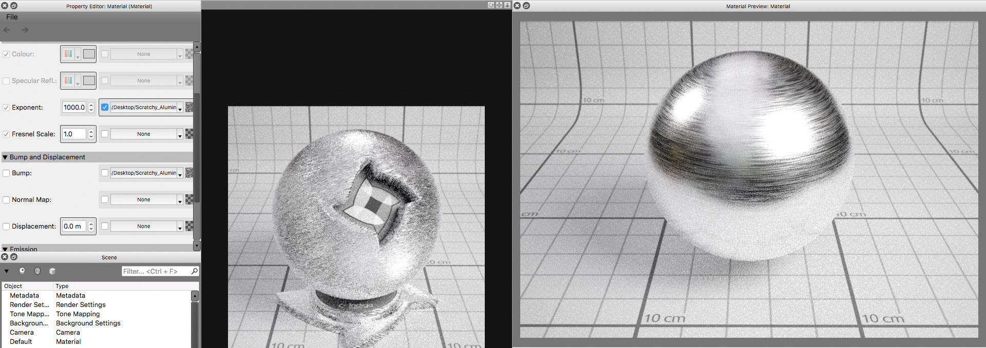

BUG
In material Preview Window BUMP channel makes sphere primitives *un subdivided*
( Not only sphere primitives but teapot too < serious problem :) )
Was perfect in 4.31.
Also when BUMP is OFF then objects are back to normal.
Post by CTZn » Sun May 01, 2016 10:38 am
That's a telltale that the bump value is too strong, and that it points to the displacement realm rather. Basically, if you have black zones away from the terminator (edge of shadow) when using bump, then you are doing it wrong. I understand that the here material is reflective though.
I know that well for I have explored procedural anisotropy, à la Passionated. The narrower the map details (ie the higher the frequency), the lower the gain. Twice the frequency, half the value. That simple. It's illustrated in the shader, where gain is divided by frequency.
By the way, displacement is just perfect now, performance-wise. Done right !
PS: example: if the distance between two peaks is 2mm, then a gain of 1mm will average their slope at ~45°.

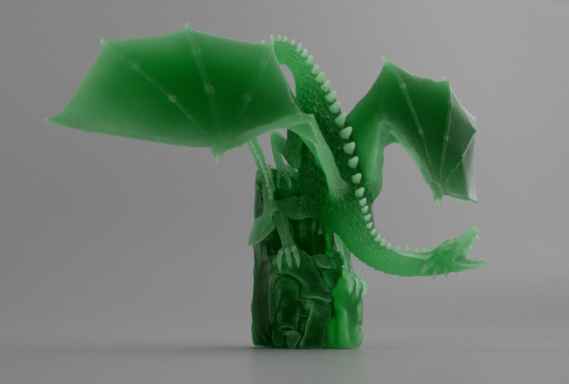

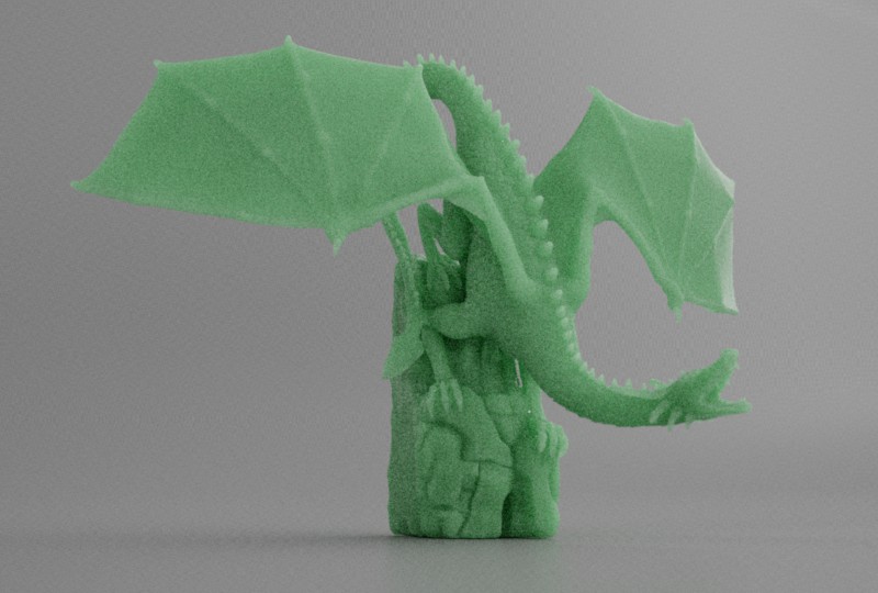

Post by pixie » Mon May 02, 2016 7:38 am
FastSSS gpu vs cpu
It screams fast!
The material clearly shows this behavior
jade.zip
Material
(598 Bytes) Downloaded 273 times
CPU
GPU
Patrice

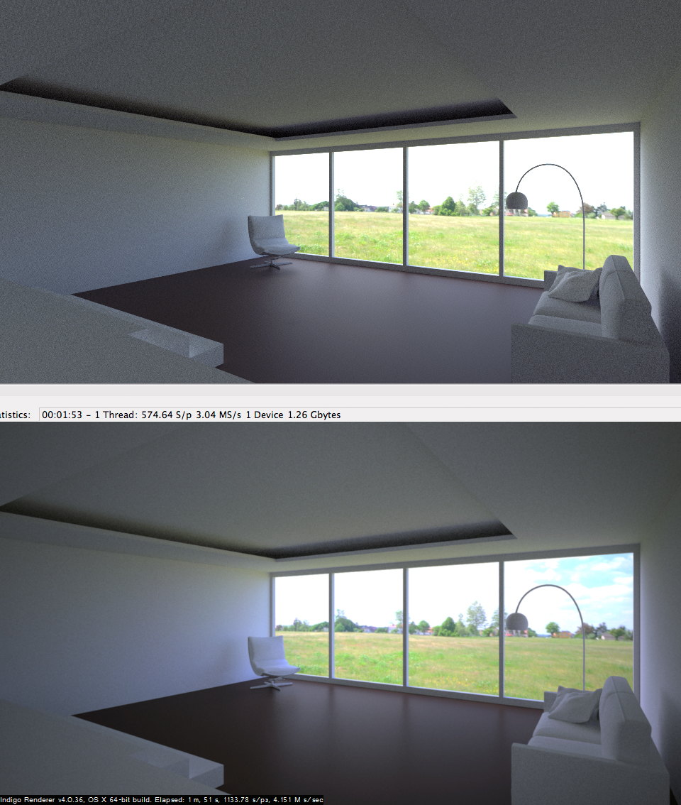

Post by Patrice » Mon May 02, 2016 3:59 pm
Except on Mac Pro, somebody run GPU mode on a Mac to render something else than a sphere ?
If yes, what is your configuration ?
Thanks
