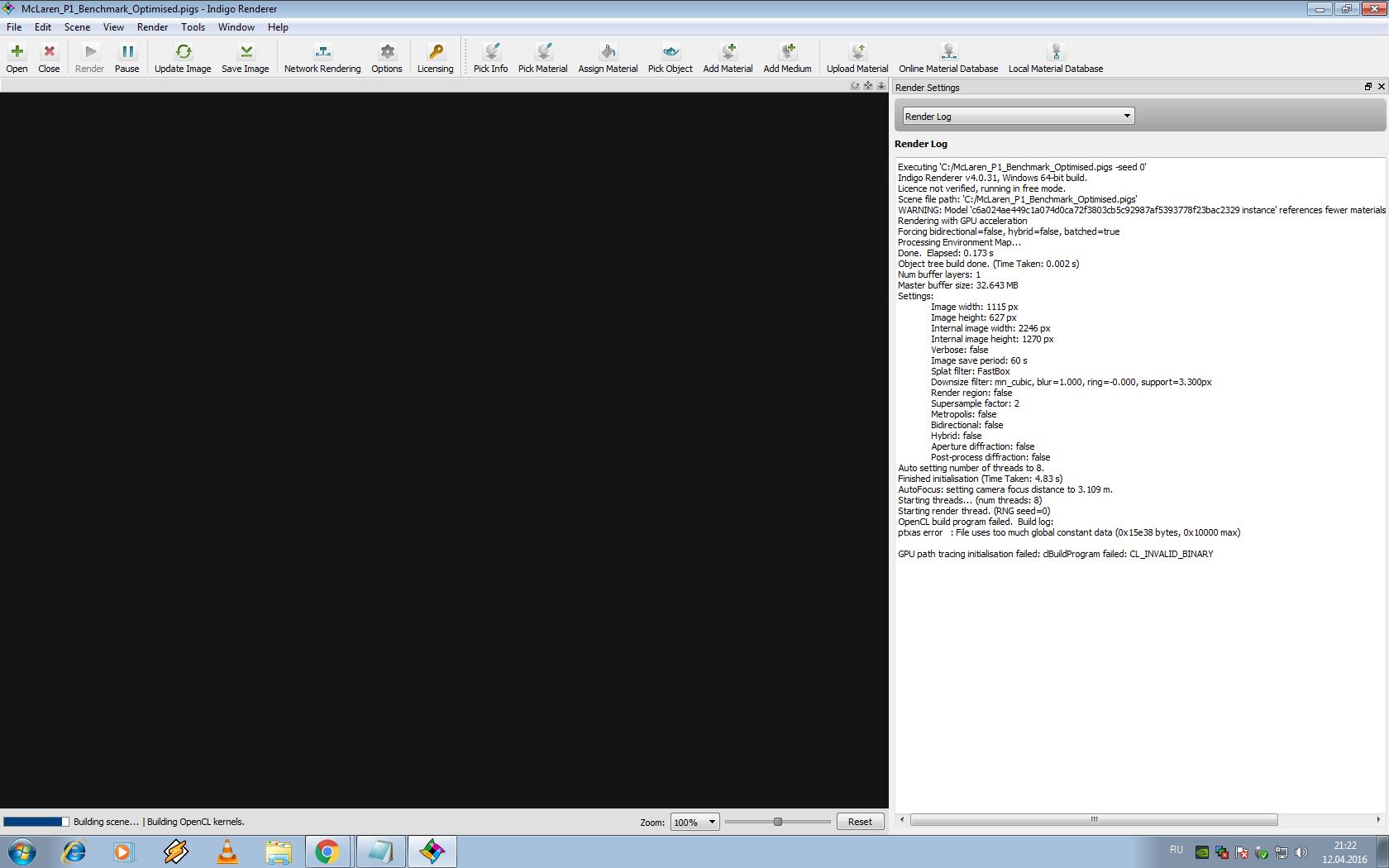

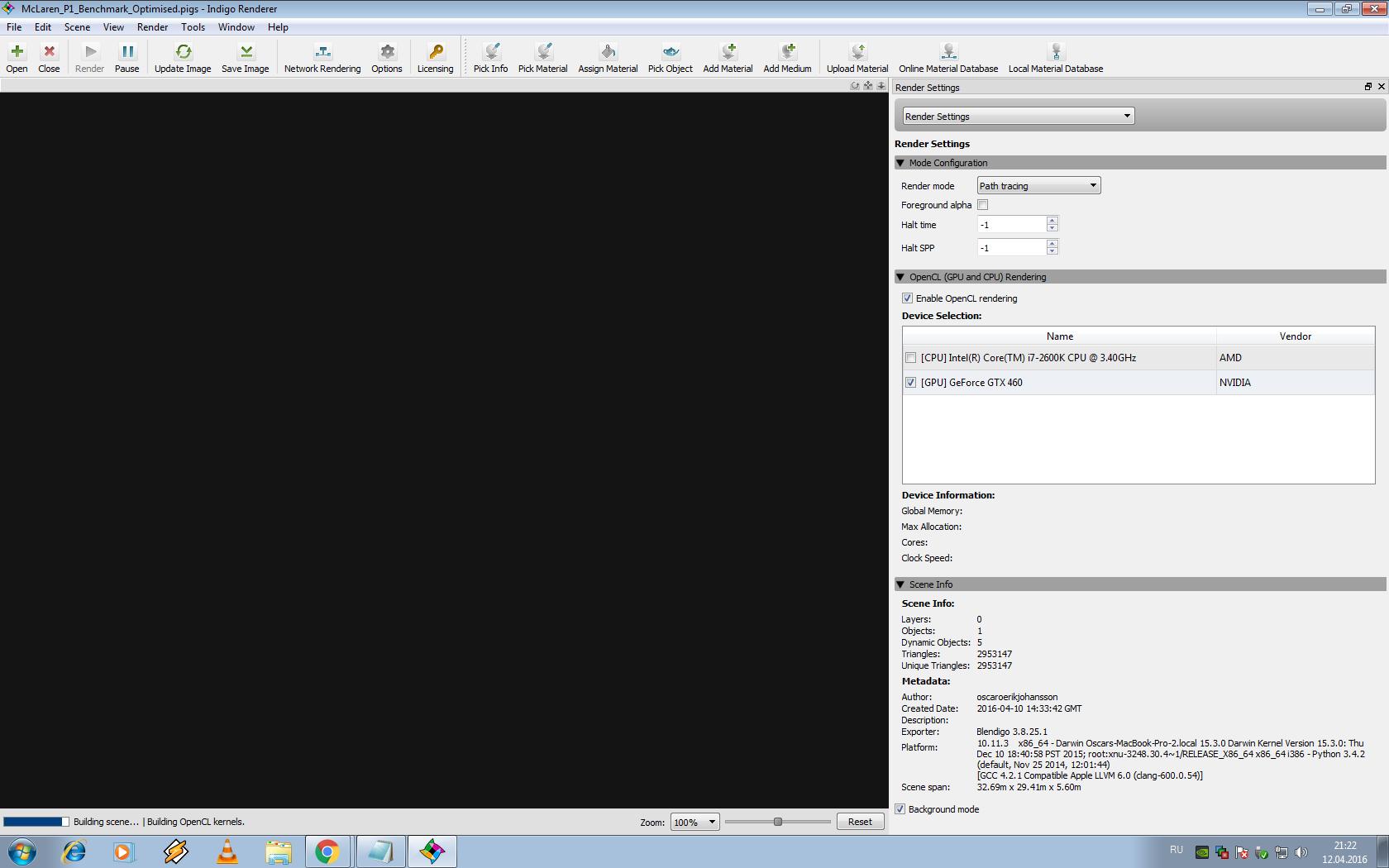

Why doesn't GPU GF460 and 660?
Maybe I someone to give a concrete answer.
may configuration
GPU not working
GTX 460 2GB GDDR5 256bit
OpenGL 4.1
my 2600K CPU supports the instruction

Anyway about your GTX 460 I didn't find it listed in the products that support OpenCL here
https://www.khronos.org/conformance/ado ... cts#opencl
So will not work for GPU rendering. About the 660 need to work and others can give you better hints.
Edit: looking here https://en.wikipedia.org/wiki/GeForce_400_series appear the 460 does support OpenCL 1.1 needed from Indigo, so better you follow others suggestions about your drivers version.

I'm only unpaid Betatester but worked and tested the v4 Beta for many weeks now, and own 2 GPUs that are very close to yours, therefore I thought I could help since your very bad desribed problem sounded like having old GPU drivers.Prof4D wrote:I do ask that they pay developers?
I have a renderslave with an NVIDIA GTS 450 and a GTX 660 both run Indigo!Prof4D wrote:Why doesn't GPU GF460 and 660?
see here: http://www.indigorenderer.com/forum/vie ... =1#p135035
Don't expect miracles from your GTX 460

If the developers wrote the {using all your OpenCL devices NVIDIA, AMD and Intel GPUs} why doesn't it work for the GPU.
When you run Indigo 4.0.31 the result is a black screen.
GT 460
OpenGL 4.1
Driver 364,72
the K2600 CPU
GT 460
OpenGL 4.1
Driver 364,72
the K2600 CPU
