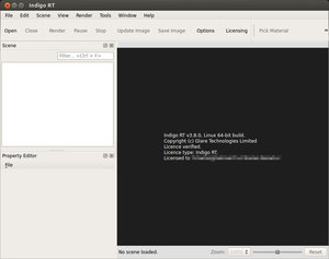

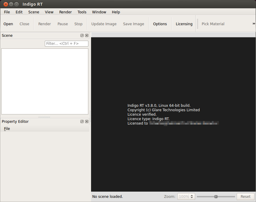

On linux (ubuntu 13.10 x64), the interface is lacking all the icons, witch this message error in the console :
libpng warning: Incompatible libpng version in application and library
libpng warning: Application was compiled with png.h from libpng-1.2.42
libpng warning: Application  is  running with png.c from libpng-1.4.3
