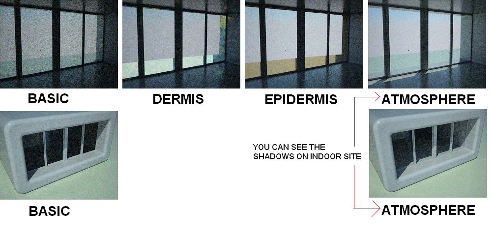

Hi my probleme is with glasses. Unfortunately I dont know which setting is the best. I realised that the DERMIS and EPIDERMIS is very bad in the medium type list (or I dont know what can I use for this).
The ATMOSPHERE and BASIC settings is true but I have some problem with there.
When I choose the ATMOSPHERE setting I can see shadows on interior site JUST why can NOT set IOR when I use ATMOSPHERE.
AND When I use BASIC setting I can set IOR BUT cant see shadows on indoor (on the rooms) :?
and the last question is when I switch off bidirectional setting only in this case get perfect transparent glasses. Why? :idea:

Dermis & Epidermis are two layers of (human) skin... using it for windows will suck :)
Basic is the medium type to go... atmosphere is afaik not really finished/bugfree, so use at your own risk :wink:

Crank up your MNCR.
Use basic medium type.

MNCR ?
Post by Kram1032 » Wed Oct 31, 2007 4:00 am
@ Gog: Max Num Consec Rejections...
You find it in both your exporter and in the inifile ;)
@ zsouthbody: be careful with new and/or not too frequent users, many might not know, what the shorts mean ;)

got it, I just had logged it in my meagre mind as 'Rejections' :)
