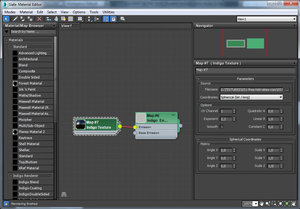

How to set the Gamma value in 3DS MAX in HDRI?
I tried already to write the desired value for all the input fields
I probably do something wrong?

Hi oleg,
that would be the "exponent" field.
Please note that Indigo usually doesn't let you override the gamma. It will only let you do it for file formats that do not have the gamma embedded (or defined by the specs). There is a "force gamma" or "override gamma" option, but I don't think any plugin (or even Indigo's UI itself) supports it currently.
That is, if I recall correctly. Maybe Ono-Sendai can shed some more light.
I will try to add that option in the next IndigoMax release (and rename "exponent" to "gamma")
