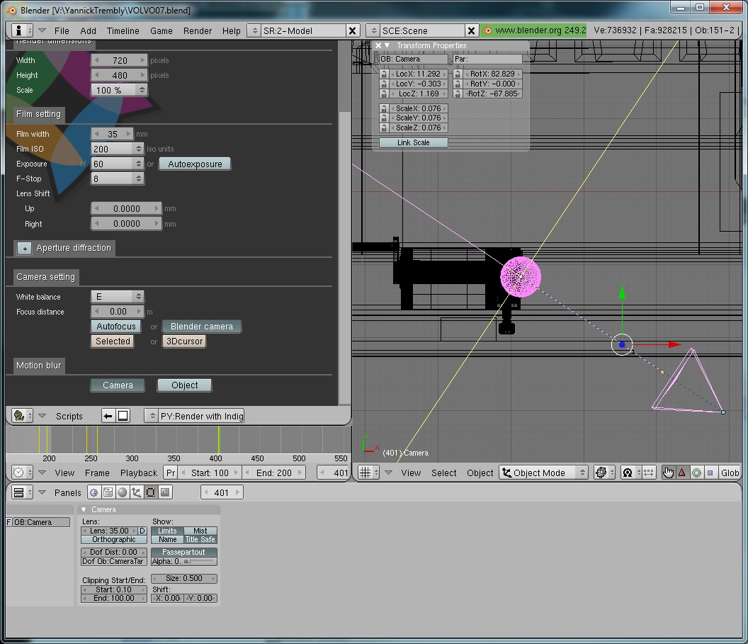

PROBLEM 1 :
I have built a scene, added a camera, set the DoF focus on the camera, told Blendigo to use Blender Camera. When I render the scene, Indigo tells me that I cannot have o focus distance of 0.00. Why doesn't Blendigo update Focal distance based on Blender Dof Ob???
PROBLEM 2 :
Even when changing Film ISO, Exposure and F-Stop, I can't seem to be able to get any kind of camera motion blur???
SCREEN SHOT :
Following screen shot illustrate :
- Blender Camera setting
- Selected Def object
- Blendigo Camera setting (with 0.00m Focus distance???)
Thanks in advance,

I notice in your Blender screenshot you have the camers DofDist set to 0.00 - that is probably your focus distance problem?
I see that you have the DofOb set, and it seems that Blender should perhaps update its DofDist for Blendigo to read. In any case, if you select your camera target and use the 'Selected' button in Blendigo, it should update the focus distance manually (bear in mind that the distance will probably be set to the centre of the object, not the nearest face!!).

This does look like a retarded bug in blender. If you set a Dof Ob, the DofDist does not get updated, despite the 3D view showing where the focus point is:

If you select your Dof Ob, and press the 'Selected' button, Blendigo does correctly calculate the focus distance:
