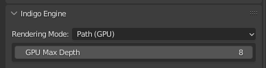

Posted: Thu Dec 08, 2022 7:03 am
by Headroom
I changed my own copy of the exporter and added some parameters to the Blendigo UI. This required only minor changes to two files in the Exporter sources and I can share those if there is interest. I've also contacted the maintainer of the exporter of the Github repo to see if he's interested in adding these to the Github repo.
The GPU Max Path depth is exposed if the render mode is set to Path(GPU) or is set to Custom with GPU rendering enabled:
- GPU Max Depth.png (6.61 KiB) Viewed 96058 times
