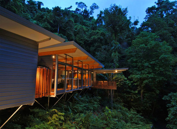

at the moment i am trying to render a scene that has a normal sky and a building that is lit inside, and the lights inside need to show up.
the sun is drowning out everything! my scene is basically a "box" with one opened end which is a face with a transparent glass material. inside this box are meshes with emitter materials.
I want a semi-bright sky with the inside lamps showing through as lighting up the inside (see examples).
Can someone give me a description of how to set up the scene?
Thank You ever so much...
Attached are some example / reference pics.

You simply need to raise the emitting power of your interior lights material.... a lot :)
Keep your emitter mesh as low poly as possible and as Big as they can be for best performance.
Use linear or camera tonemapping for adjusting emitters and simply play inside Indigo GUI with the settings for some working values.

thednx, you didn't mention that you used the camera tonemapping feature.
1 - please do
2 - tweak camera optics to match the desired sunsky setup (edit: read: output)
3 - lights will follow
Screw Reinhard's tonemapping method when it comes to calibration.
