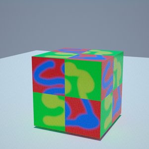

Try using Indigo's Material Editor to make the Blend then refer to it from Blendigo as an external material type.
For example to test this out I created a 3x Blend material in the editor and then rendered a simple cube using it. Worked with no problems
3x Blends in one material
The simple scene using the external 3xblended material
and finallly the Indigo .pigm material file so you can load it into the Material Editor and Blendigo to try it for yourself
TestExternalBlend.pigm
(25.7 KiB) Downloaded 322 times
