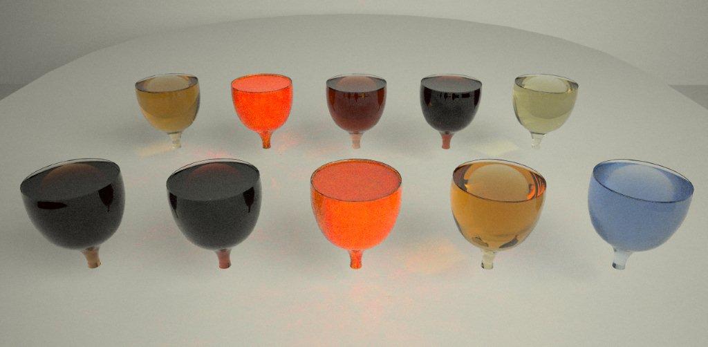

Rendered with Indigo 0.8. The orange liquids are actually chocolate milk and regular milk. I think they are orange just because the convergence is so slow for this type of scene (10 liquids all with SSS, milk has VERY high SSS). I have tried the same milk values in another simpler scene and the milk seemed to render correctly (using Indigo 0.8).
Back row left to right: apple juice, chocolate milk, cranberry juice, grape juice, chardonnay
Front row left to right: coke, merlot, milk, budweiser, gatorade
All liquids using values for 100% concentration from the PDF I recently posted. Diameter across the top is 7.5cm for all liquids.
approx 9 hour render

Hi Whaat,
looks pretty good, apart from the Milk. That is just wierd :)

when i had this problem with milk (yes, the same problem), I changed it to glossy transparent, and it rendered fine. Try it in Indigo 0.9 test 6 and see if it comes out different.

Well I'm just setting up my own SSS test scene (wine glass), so I'll test it soon. But it definitely shouldn't be orange.
Tell me, what are your render parameters?
Can you paste the inifile or renderer_settings?

I don't have the render settings right now but I know I had Bi-dir MLT=on and I think MNCR set to 1000 (I never use lower than 500). I never change the inifile so the settings are the default from Indigo 0.8 stable.
I am now thinking that the orange color of the milk is due to a bi-directional bug. I rendered the milk again with with the same settings and it was orange. Now, I am rendering with bi-dir off and the milk is coming out white. Will post soon.

It could be a bug with bidir, yeah.
It's interesting to note that the absorption colour of milk is more or less orange (i.e. the absorption coefficient is lowest for red light).
What we are seeing in your renders looks something like the milk liquid being rendered without scattering being taken into account. Why this would be the case is a different matter entirely. :?
