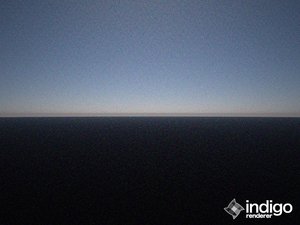

Something happens with the perfect spheres beyond a size:
from globe_test in atmosphere at 10 m of height. (CPU PT)
In this case GPU isn´t able to process well with a perfect sphere like atmosphere shell. With a mesh, performs satisfactory but please, sure that could process more rounded !!! Still doing accused jumps... (little GPU).
The test is with henyey-greenstein phase function, 12 minutes test.
CPU : 23.36 s/px
GPU: 54.17 s/px
CTZn, thanks fir the tip! The terrestrial atmospheric medium starts at 6378135 m and ends at 6458135 (yes 80 Km.). The inclusion of the ozone maybe changes the distribution and the specific real tabulated medium mixture of gases but don´t modify the range of expression, though.

yonosoy wrote:In this case GPU isn´t able to process well with a perfect sphere like atmosphere shell. With a mesh, performs satisfactory but please, sure that could process more rounded !!! Still doing accused jumps... (little GPU).
GPU renderings doesn't support sphere primitives! Maybe in this case its different, but beware...

Sorry, finally the bug was not specify (because the ability of process the atmospheric simulation with GPU probably was there time ago):
When there is defined a perfect sphere for the earth, materials like specular and phong works well, but materials like diffuse and oren-nayar gives a black zone when the camera is below (don´t remember but near 60 meters of altitude).
This is and old bug that was forgoten !! Don´t know if has any use, the try years ago was to study objects with atmosphere simulation (has no meaning :) , but i like). Actually is understand that all this means to overload indigo innecesarily. But once the atmosphere is defined, a downspeed for an earth was never noticed for a basic material (?).
