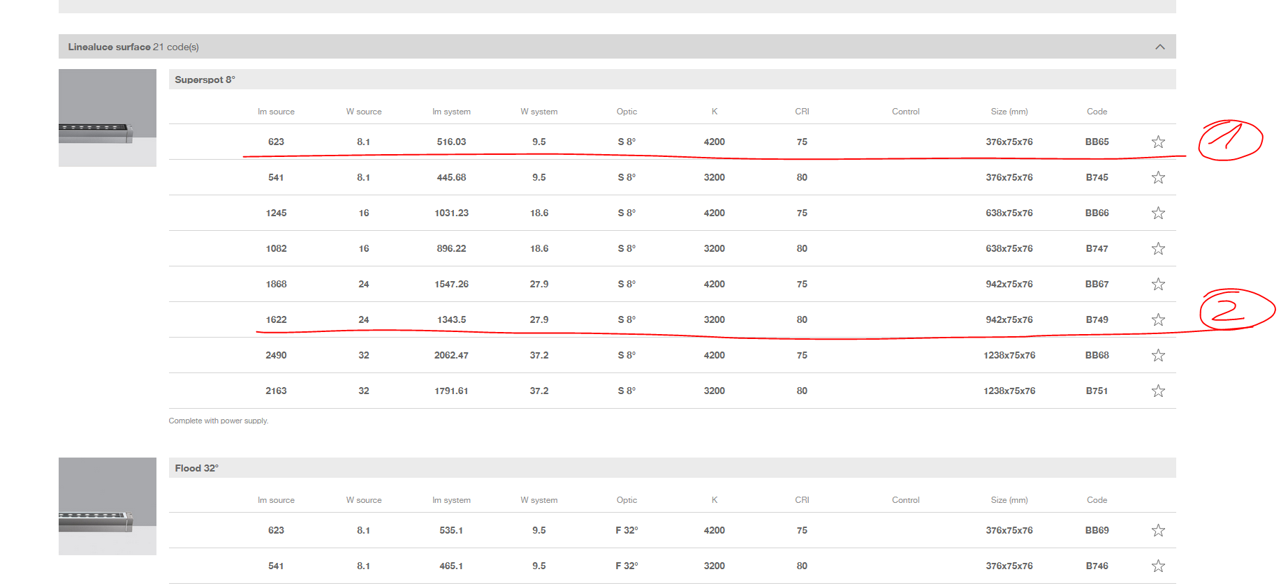

Here is the link to the products and I also attached screenshots where you can see, which type of light I used.
https://www.iguzzini.com/linealuce-surface/
version 1 and 2 of the lights
version 3 of the lights
Carsten
