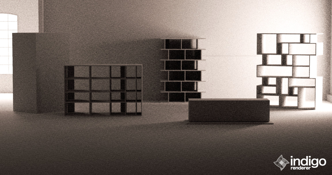

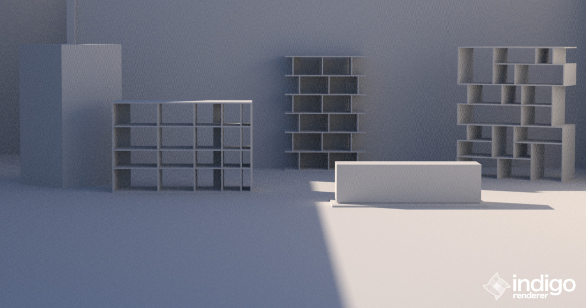

Hi, so I had a go at creating the model and while it isn't 100%, then started playing with the renderer. The 1st image is with the sunlight and no roof and the 2nd one (v1) is with exit portals with an enclosed space. I had issues with glass in the windows in front of the exit portals, as while the environment was lit up, the windows were black. So I removed the glass.
Overall I need to add more windows into my model as the scene is dark in the middle. But a start at least and really pleased with how easy indigo seems to tweak things. I'm sure the more complicated stuff is to come!
Apart from what I pointed out above, any other tips or things I should look at now before cracking on with the rest?

Re: Newbie - Help!
Good start!
To achieve something similar to the first image you attached, you might want to use an environment map, which is a 360 panorama in .hdr or .exr format. I can recommend these: http://www.viz-people.com/portfolio/free-hdri-maps/
You might want to choose one that's cloudy to get close to your reference image, since it doesn't have sharp shadows. Preferably use the HDRI together with exit portals (with their normals pointing inwards) and Bidirectional Path tracing as rendering mode, as it's robust and fairly quick for interiors. More on HDRI's: http://www.indigorenderer.com/documenta ... t-settings
With this type of lighting, along with more windows, your scene will hopefully be more balanced and the lighting slightly less dramatic. Keep in mind though that if you feel that the render is to dark, too light or too contrasty, that's easily adjustable by changing the tone mapping. For example the afgapan-apx cameras have low contrast and neutral colours. The filmic tonemapper also does a good job with brightening up interiors, with high enough "Scale" value.
More on tonemapping here: http://www.indigorenderer.com/documenta ... ne-mapping

One note : i think on the right of the image (judging from the original image) there is a very big window
think of industrial loft houses. So it might be your have to make your exit portal bigger on the right side.
Or if you have an actual cutout for windows on your setup then make sure you controll the natural sunlights direction! You can do this in c4d with a null object...or inside Indigo with long and lat coordinates.

Yeah I noticed that so will definitely put a bigger window or more of them on the RHS. I guess with HDRIs I wouldn't need to use exit portals behind the windows but just where I feel the light is lacking, e.g. in the scene, out of shot, where a photographer may use it to remove shadows etc. All the windows are cut-out to let the light shine through!
- Oscar J
- Posts: 2204
- 3D Software: Blender
Re: Newbie - Help!
Seems like something is getting mixed up here. An exit portal does not give any light in itself. It's an indication for the renderer where the light enters the room from the environment, and which often means faster rendering. You can put them in the windows, outside any eventual glass, and with the surface normals pointing inwards.
What you're thinking about are probably mesh lights. They are simply planes or spheres with an emittive material assigned, and can be used as light bulbs, fill lights, etc.

Right that makes perfect sense now, thanks. So you'd recommend them with the use of HDRIs for more of a performance than a lighting reason.
