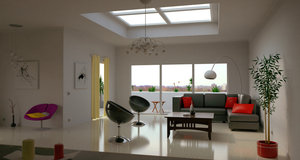

Hi all!
Here's my first attempt at using an environment map.
Used Sketchup / Skindigo.
Thanks to Pibuz, I took many items from the SU Warehouse, which saved a lot of time for the modelling part!!!

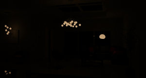

I had trouble finding the right Camera settings, because the env map is so bright compared with the room.
If I lower the overall brightness I get a nice blue sky outside, but a nearly totally dark room...
- Render with lights "on"
- Render with lights "off"
I also have trouble finding the right settings for the lights - I wanted them to diffuse light all over the room, but all it does is glow...
(I used Skindigo's "fluorescent - cool" material preset)
- Lights only

You have to change your cam settings for the lights.
Raise your iso or ev values for example.

Hi Mad!
The image you post is very inetersting indeed!
First of all, always remember that an interior shot will almost always (97% of the cases) show overexposed exteriors
That is a natural consequence of the optical properties of cameras, included Indigo's. So, to increase realism, a first step would be to make the EXR map even a little brigher, according to me.
The values you find in the emitter presets are to be used only as a starting point. They have correct colour, but powers can vary given the different size of the geometry they're applied to, and the different environment conditions. Working with a surrounded EXR could be the "issue" here: I suggest you put the emitters on a different light layer and then adjust their power while the render is running with the layer blending option.
Btw, the image is very particular, and there are a lot of good starting points. I was wondering if you could share the settings you used for the lamp on the right (dome's materials) and the floor.
Can you also link us to the models of the pictures please? They're cool!
I'd work a little on the couch's material: I see better a diffuse (simulating a fabric material) than a phong (leather-like material)
Keep going!

Hi!
Thanks for reassuring me regarding the env.map's brightness.
Regarding the pictures on the wall, I took them from
http://www.cgtextures.com, in the "Splatter" section - except I changed the red paint to black in Photoshop.
The floor's texture is from CGTextures again, under the "Marble > Noisy" section.
I'm not at home so I can't give you the IOR/Exp settings right now but if you want them I can post them later on.
That's what I did, but I lowered them a lot because I had bright white balls, and I wanted to get some kind of "natural incandescent light" feeling.
I used the same "fluorescent-cool" preset for all the lights (including the one on the right).
But I'll work on different light powers later on.
@Suvakas=> thanks for your comment. I showed this picture just to illustrate the fact that I don't get any radiance from the lights - they don't seem to be emitting light around them... This is probably due to the light power too, but when I raise the blending setting I lose this "bright yellow" feel...
Maybe I should start with an incandescent light preset (very yellow), so I can keep this yellowish feel even when raising the power and blend settings...
@Pibuz=> I quite like the current couch's material, but I also agree that a fabric material would be better.
I actually think that a leather material looks best with more detailed models (creases and bumps showing that people have been sitting on it), which is not the case here.
I also want to add a book on the table, lower the reflectivity of the table's material, and add a couple of car-keys or house-keys in the foregrown to liven up the scene. I'm also going to lower the brightness of the plants' leaves' because they look so "plastic-made".
Many thanks again for your comments and help guys!
Hmm..not true. Just wrong camera settings. You can't expect to have the same kind of illumination with daytime cam settings at night? I adjusted the gamma of your image a bit tho show you that the light is there.
Re: First use of an Environment Map
Posted: Fri Apr 09, 2010 10:19 pm
by madcoo
Thanks for proving me wrong !
It's all gonna be about cam settings, then...
I'm struggling but I'll get there some day !!!
Posted: Fri Apr 09, 2010 10:26 pm
by suvakas
You can also adjust the power of your lights.
The final image is a balance between the right cam and emitter settings.

Hey Madcoo
Nice scene here.
The difficulty using Env map with lights (or Sun with lights) is that the little lights' power is often too low comparing to the env/sun.
I find very difficult setting the correct light powers at the beginning, but once you have done it once, you can use it anytime !
One solution, if you used light layers, is to increase the light layer's power while rendering, or, if you turned off the env (or sun) change iso like suv said (talking about the black image). There are many solutions, and i think each person has his preferences.
I read somewhere that the sampling was distributed proportionnally to the powers of different emitters. I often "cheat" by giving very imbalanced power to little bulbs, and reducing it while rendering, I really find that technique efficient, but very experimental!!!
