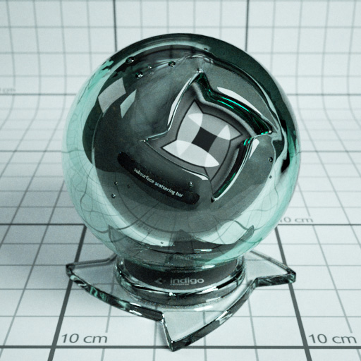

I jut tried to use the tabulated data 1:1 for the absorption Spectrum of a Specular Material. My result is quite strong tinted. Do I have to modify the data (devide by 100 or something) to get get a propper result?!
Default Test Scene Whitebalance of E
**edit**
ok, I changed the white balance from preview scene default E to F7, so the result is nicer.
WB Setting E realy tints the image green (as you can see in the BG ramp)...
Hell knows why it is the default in the Preview scene...
Whitebalance set to f7

The data is to be used "as provided". I'ts already in m^(-1) units and I'm 100% sure of it.
I'm not surprised a 10cm sphere looks tinted anyway. This glass is used for windows, thickness is generally 6mm (or 2*6mm for insulating glazing units), and I know the tint is already sightly perceptible. So for a 10cm sphere, it has to look tinted.
I think your model is OK. Just check the refractive index coefficient : good values are 1.51 and 0.00424672.
More glass data to come soon...
Etienne

Looks good. Can you upload to the MatDB Zom-B?
Re: Coated glass from real measured spectral data
Posted: Mon Jan 11, 2010 12:12 pm
by Zom-B
The 0.00424672 is meant to be the cauchy B parameter, right?!
Rendering a preview image and uploading when done!
Posted: Mon Jan 11, 2010 2:04 pm
by Zom-B
OK, I uploaded the material to the Database: http://www.indigorenderer.com/materials/materials/250
tanks a lot for the Data galinette, I'll use it for sure :)
looking forward to more Tabulated data, and having tabulated IOR would be a nice feature too master Ono :wink:
