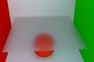

Is it possible to achieve something like that with single plane geometry with Indigo? In Maxwell (picture from maxwell forum) there is asymmetry setting in material for both sss and thin-sss, here I can't find it in diffuse transmitter.

What you're looking for here is either a double sided thin (which doesn't need thickness and has the asymmetry settings you're mentioning), or a glossy transparent material (which needs a volume).

I'm not sure where I can find asymmetry option in double sided thin parameters, I can't see it in neither blendigo nor indigo UI... Do I have to edit IGM directly?

I must have misunderstood you. DST material allows for asymmetric reflection fraction, roughness, fresnel scale and base material on either side of the surface. What do you mean by an asymmetry option?

Others would know better but he may be referring to the phase function approximation setting. Non-diffuse transmitters have long been proposed since DT's out (think Phong transmitter, with lobe control).

Take a look on this luxrender thread:
http://www.luxrender.net/forum/viewtopi ... =36&t=9560
"Scatter" material in lux allows thin-geometry scattering, for baloons, pet bottles, thin plastic curtains, lampshades etc.
