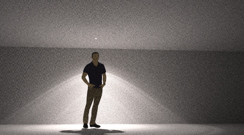

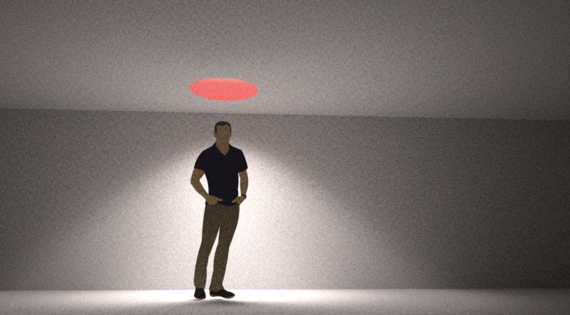

Odd one - using an IES profile for my lights, works fine when the lights are a certain size. But when I make the area of the emitter larger it stops lighting up. So for example it all works find with a 50mm spotlight, but if I make it a 200mm spotlight suddenly the source doesn't light up/glow.
Whats odd is that the light still functions and the fall off still casts on the walls correctly - its just the actual emitting 'bulb' is no longer is lit up.
It doesn't clear up the longer it renders either.
See below. Literally all I've changed is the size of the emitter. IES is the same, block is the same, emitter material is the same etc.
Working fine, 50mm spot
Not working, 200mm spot
At the moment I'm having to add white in postpro.

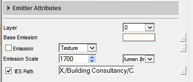

How does one go about changing luminous flux etc?
The only emitter options in SKIndigo appears to be emission scale - increasing this doesn't resolve the issue.
See below, small spot light (50mm diameter), then one increased by 4x and then the last increased by 4x again.
Obviously the emitter isn't white like it should be, and the fall off pattern on the wall is looking all wrong too. Why does that change? It looks zoomed in. Is the fall off pattern affected by the size of the light?

Bosseye wrote:Ok, thats interesting, thanks. I'm still confused though!
Glare should definitely add a way to scale the IES emission. It seems it only works without IES enabled.
