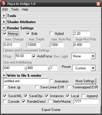

I've done some experimental work on the GUI:
- moved some controls into sections where they make more sense
- made each section a collapsible frameLayout
- put all tool buttons into shelf tabs, and removed the need for show/hide toolbox
- generally made the controls fit a bit better, also made the main window the correct size
Please let me know if this was worth it, or whether it was better before.
(I prefer it ;) )
Cheers.
This is what you first see...
... and all frames open, showing new toolbox
