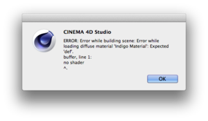

I'm messing around with the latest build of Cindigo, and was really excited to discover that there is now support for Cinema 4D's noise and procedural shaders. My excitement abated somewhat when I discovered that none of the shaders that require surface normal information work. This would include useful shaders like fresnel, falloff, and ambient occlusion. So that was kind of a bummer. Fresnel in particular is a very important effect - it would be great if Indigo had some internal way of interpreting a C4D Fresnel gradient. Fresnel effects just can't be baked into a texture map, so there is no easy work-around for this.
I also noticed that an Indigo menu appears in the shader list. Selecting "Indigo/Indigo ISL Shader" while in an Indigo Material produced the following error:
- error generated when using an Indigo ISL Shader in an Indigo material.
This error doesn't show up when using the Indigo ISL Shader in a Cinema 4D material.

forgeflow wrote:I also noticed that an Indigo menu appears in the shader list. Selecting "Indigo/Indigo ISL Shader" while in an Indigo Material produced the following error:
That is because you load up the ISL Shader that is empty.... the empty code free shader generates that error while C4D tries to render a preview of the material.
Simply past the following code into the code window if you click the shader once to get some fresnel style of effect:
def eval(vec3 pos) vec3 :
lerp(
vec3(0.9, 0.2, 0.2),
vec3(0.5, 0.5, 0.1),
maxCosTheta()
