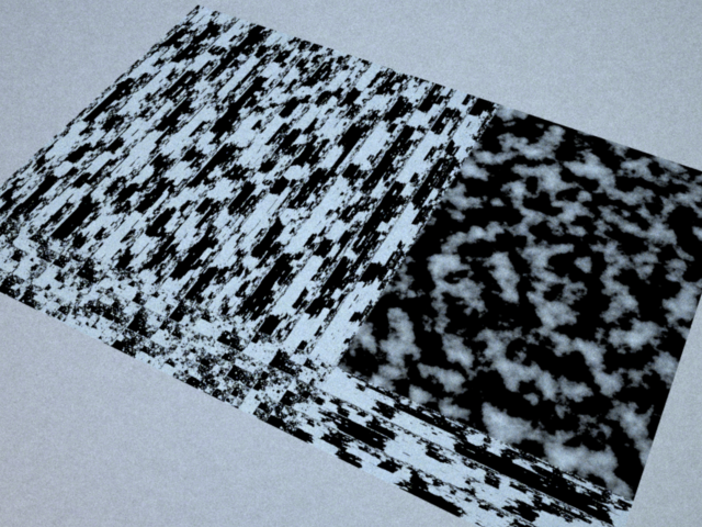

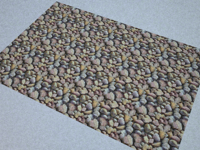

I've been testing out the new procedural fractal stuff. This is the usual type of output that I get. It seems like there is a bug with the procedural code related to the uv coordinates.
In the one image, FBM is applied to the diffuse texture.
In the other image, a diffuse texture is applied to the same geometry using the same uv coordinates.
default.zip
IGS file
(1.68 KiB) Downloaded 262 times

fused wrote:It seems like there is a bug with the procedural code related to the uv coordinates.
That could be right, but are you sure the UVs are between 0 and 1 ? They can be higher in many cases, and maybe Indigo can't manage procs above the 1 coord ?
